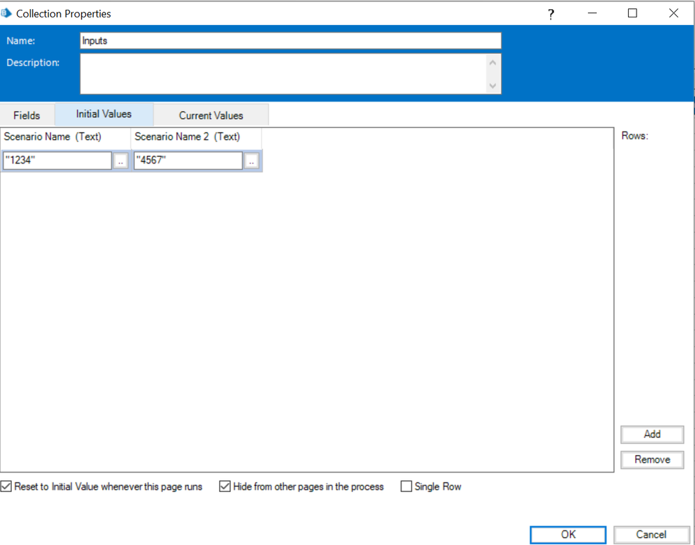

But I can suggest a very easy approach to get the desired results from the API Calls collection that you are getting. After getting this collection, you can use the 'Transpose Collection' action from 'Utility - Collection Manipulation' VBO. Below, you can see I have an input collection with the same structure as you have provided:
Input Collection:

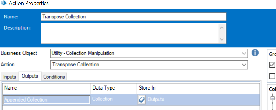

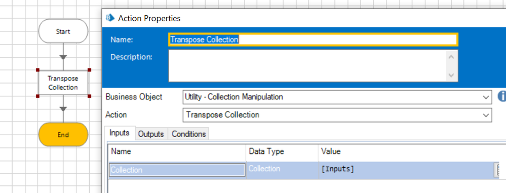

Now, if I use Transpose Collection action with the following parameters:

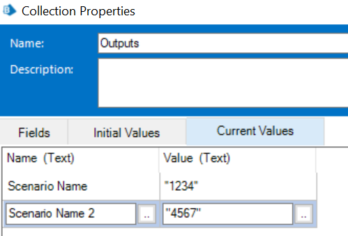

Below is the output collection that I get from it:
As you can see here, I get an output collection with two columns called 'Name' and 'Value' consisting of two rows now.
