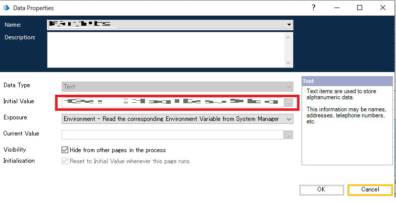

Hi, This is Pratima.
I am very new to BluePrism RPA,
I want to know how to enable Data Properties so that I can update the Initial Value. Right
now I am not being able to update.
Thank you in advance.

Hi, @Pratima I see your variable is an environment variable
Where there is: "Exposure", change from environment to "none", with this you will be able to change the initial value of this variation.If you want to keep it as an environment variable, go to system, look for environment variable Look for the variable in question and change the value, this should solve If my answer helped you, mark it as useful,

Hi Emerson Ferreira,
Thank you very much for your prompt response.
Your answer solved my problem.
