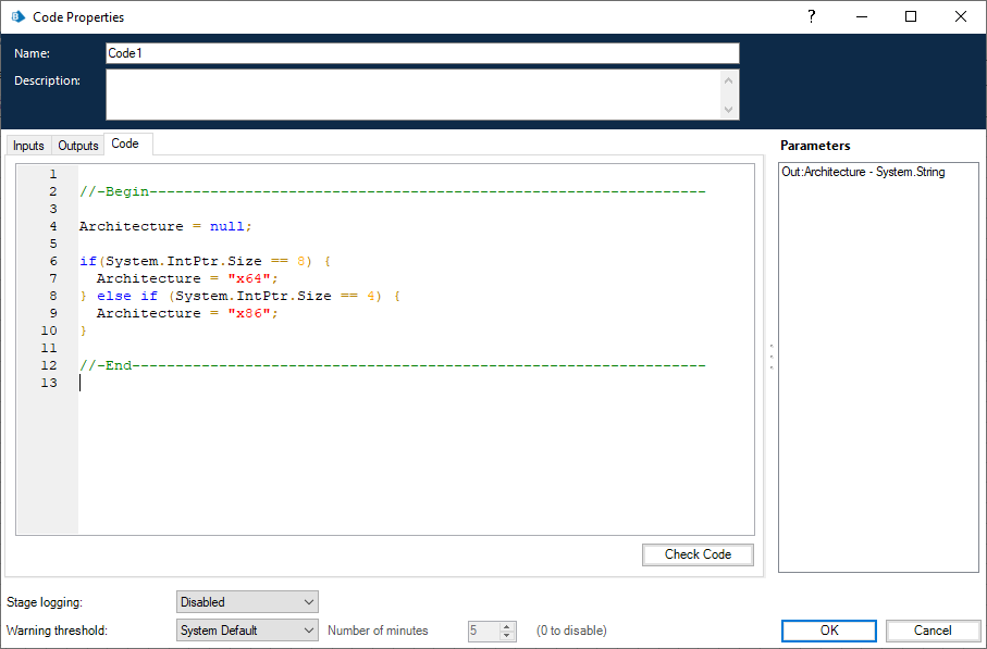

the installation of the Blue Prism Learning Edition is in the path C:\Program Files\Blue Prism... So I assumed that the application is for x64 architecture. This is important for additional libraries which should to be used. So I tested with a tiny code snippet which architecture is used.
But the result is x86.
Is there a special reason why the path C: \ Program Files (x86) is not used, although it is actually the right one?
Thanks for tips and hints.

Hi Stefan,
Blue Prism has 32 bit and 64 bit installations.
Blue Prism  core is a 32 bit application but it has components capable of x64 interaction with a 64 bit installation.

Thank you very much @Henry Li for this clarification.​
