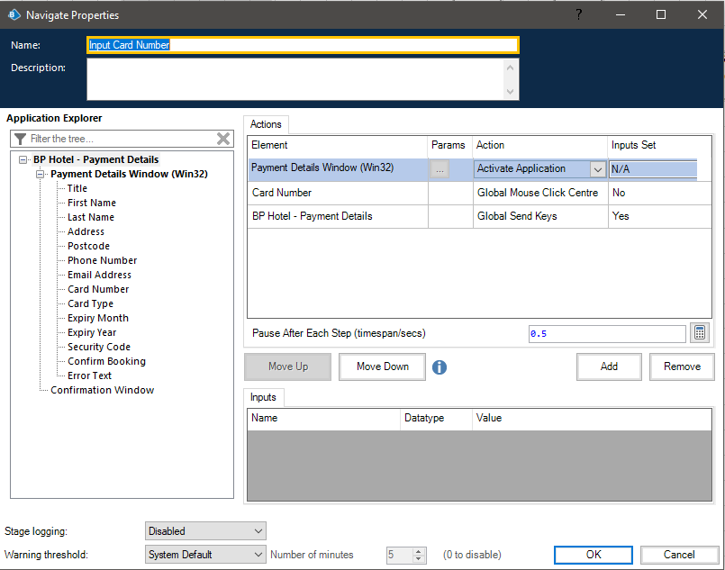

hi @SamLima ,
to activate the Card details fields you need to use the global send keys to Card Number Field to send the card number.
using navigate stage as showing below :
1- Spy the Payment Details Window using Win32 spy mood ,and use it to activate the application action to make it in focus.
2- Spy the Card Number field using java spy mood ,and use it to Global Mouse Click Center action.
3- Use the Global Send keys to send the card numbers.
