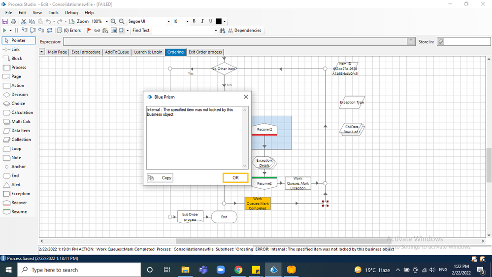

Internal : The specified item was not locked by this business object
What's this Error, Why ii's shown and how to solve it?
It occurs while mark complete stage

Hi Shikhar,
I already invoked 'Get Next Item' in order to fetch the item from the queue and set 'Keep locked' and 'Retry' to False in Mark Exception but the Error keeps occurring,
Does 'Get Next Item' lock the item Data by itself?

Hi @Sanaa Fallah
Could you share with us your complete diagram?
Sounds like you are getting the item with another Object.
