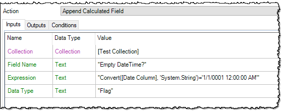

If you are looking to loop through an entire collection and branch your flow if the DateTime value is empty, you can use the Append Calculated Field action to add a Flag column to your collection.
Note: You might have to modify the default date to a format that corresponds with your Regional Settings.
