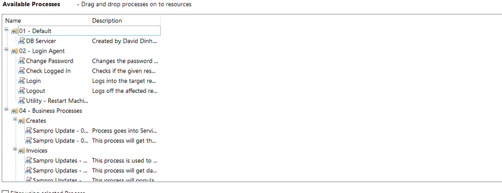

We are using BluePrism to run our process. Today morning suddenly, I am not getting the resource section is not available in the control room. I am getting the below screen only. Could you please guide us how to get the available resource machine in the right-hand side?

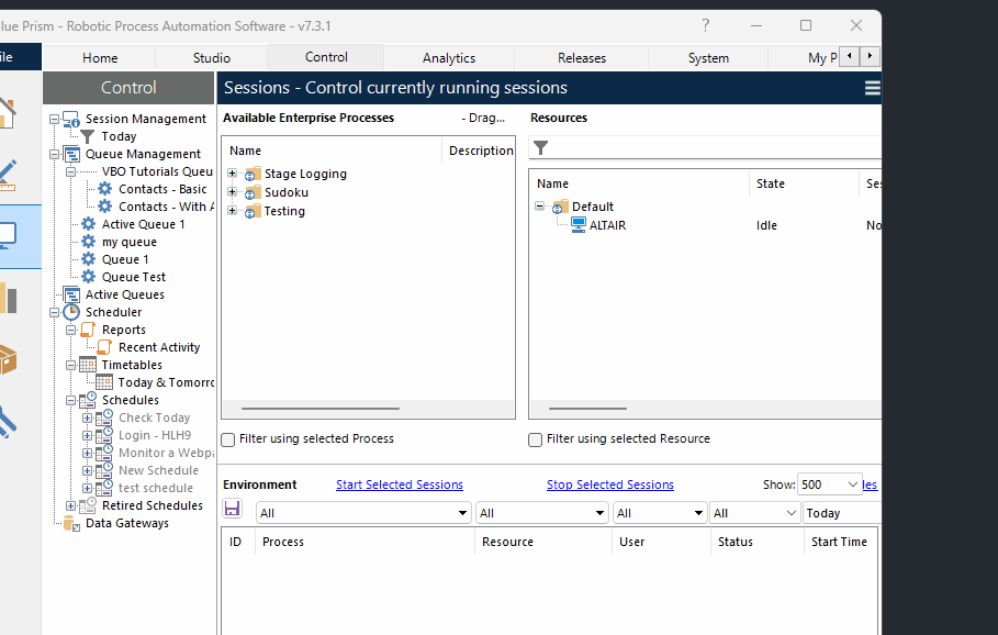

It kind of looks like the Resources pane that is normally at the top right is just dragged off the screen. You can resize the panes in Blue Prism to such an extent that this Resources pane doesn't show at all. I don't believe this is possible with permissions, so I would assume if you carefully hover your mouse over the far right side of the screen, the mouse cursor should change to indicate you can left click and drag the bar toward the left so the Resources pane shows again.
