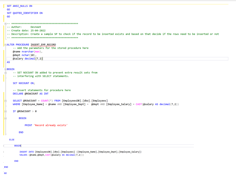

Now, I will create a stored procedure for the table which will accept three input parameters for Employee Name, Employee Department and Employee Salary as shown below. Here the name of the stored procedure is 'INSERT_EMP_RECORD' :
In this stored procedure, I am checking first if any record with the given input parameters exists or not. If it does not exists, then I am inserting the records only.

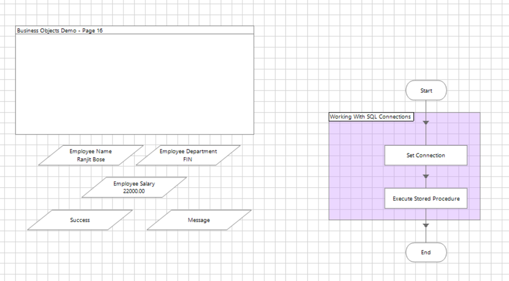

Now, in your Blue Prism Process Studio you can create the following workflow:
Here I have taken three variables which will be mapped to the three input parameters going ahead and I am using values such that a new record will be inserted. Now, in order to execute the Stored Procedure, I will use the following query:
"DECLARE @return_value int EXEC @return_value = [dbo].[INSERT_EMP_RECORD] @name = N'" & [Employee Name] & "', @dept = N'" & [Employee Department] & "', @salary = " & [Employee Salary]

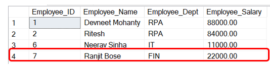

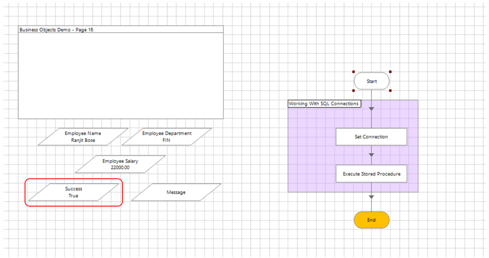

Upon executing the workflow you should be able to see a new record getting inserted as shown below:
