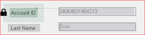

Anyway, your suggestion worked thanks. In Region Editor, seems you need to zoom in to ensure your region edges are drawn in-between the input field borders and the text values contained therein. Example attached for Account ID field.

Surface automation is a demanding technique at present, where any 'noise' in the region, such as a border or stray pixel will contaminate the image being analysed for text. When things that should work don't, the first check is to see if the region/image you are asking BP to analyse is clean, or is there a chance that something is getting in the way? A simple test is to extract the region as an image data item using the same Read stage, then open the data item and take a look at the image - you may be able to immediately see the problem.
