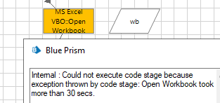

I am facing below System Exception ,
System Exception:could not execute code stage because exception thrown by code stage:Open workbook took more than 150Secs.
To resovle this issue what could I do please help me and what is the reason of this error please let me know

Hi @KETAN SOMAN
Sometimes excel will take more time to open so we need to give more time to open excel so you increase time in time out variable to around 500s in open work book action

23-12-22 07:17 PM
Hi
Just Increase the wait in respective VBO (completely based on your INPUT xlsx file size)
