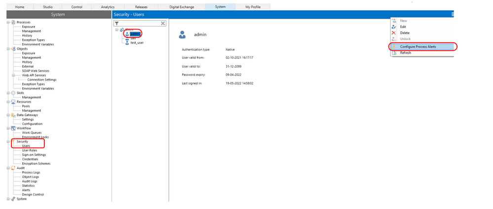

1) Go to System tab -> Security -> User and select the appropriate user from the user tree and click on the right hand side hamburger icon and select 'Configure Process Alerts' option as shown below:

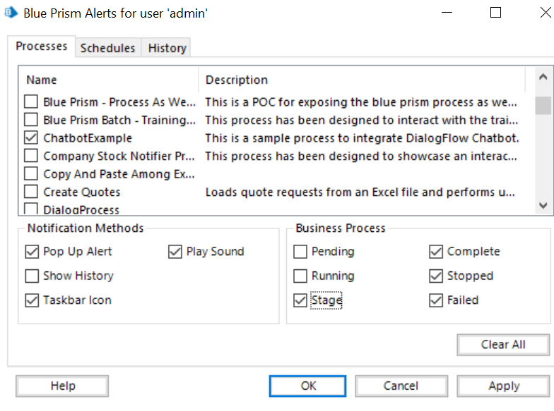

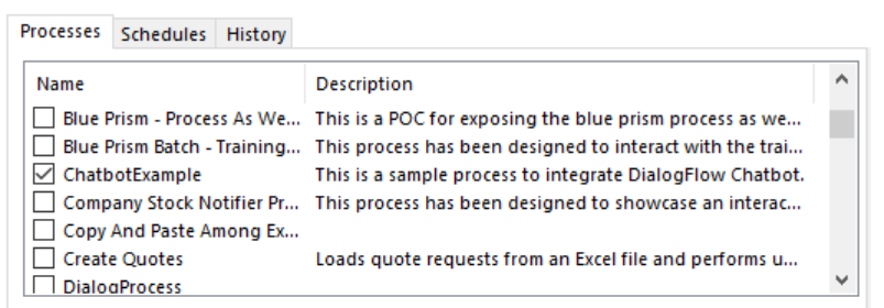

2) Ensure you have selected the process for which you want the alerts to be generated:
32456.png​

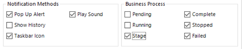

3) Make sure you select the notification methods which I recommend generally as Popup Alert, Play Sound and Taskbar Icon along with Business Process settings as Completed, Stopped, Failed (When the process will be finishing to be executed) and Stage (Which basically will be triggered when the workflow reaches your Alert stage):
Click on 'Apply' and 'OK':

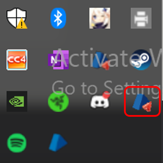

4) Ensure your process alert monitor service is running. You can turn it on by going to CMD and providing the below commands:
Automate /alerts /user "<username>" "<password>​"

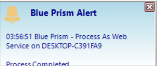

You should be able to see this action in your task bar hidden icons section:
5) Now run the process from Control Room which has the alert configured in the prior steps:

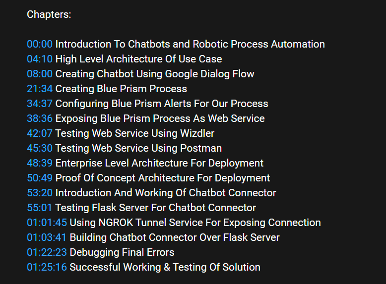

Hi Sam,
You can watch my video on my YouTube Channel: Dialogflow Integration With Blue Prism
Here, from 34:37 min you will be able to see a 4 min clip of how I have set up alerts in real time.
32456.png​
Email: [email protected]
Thank you @Devneet Mohanty, it worked I was typing the command with spaces
