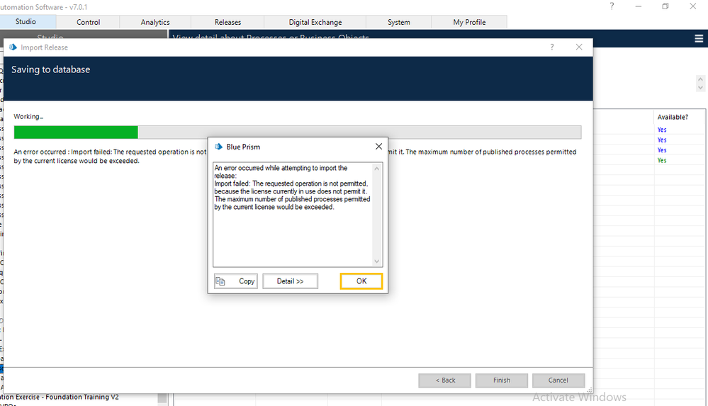

I'm trying to import a release but this error occurs
An error occurred while attempting to import the release:
Import failed: The requested operation is not permitted, because the license currently in use does not permit it. The maximum number of published processes permitted by the current license would be exceeded.
what to do?

Hi @Sanaa Fallah
This looks like you have too many Process published with the "training licence". The maximun number of published process that you can have at the same time is 5.
Try unpublish any other Process to solve the problem.
