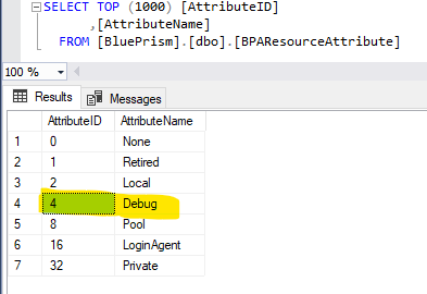

Have you checked the BPAResource​Attribute table to see if there's an entry for AttributeID = 33? I don't have that in my test database, so I can't say for certain what it is.

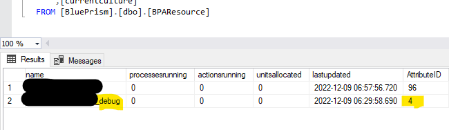

For me BPAResource​Attributes shows some of the common Attribute IDs e.g. 4 is for Debug Resource. In my case Attribute ID is 96 but could not see any entry in BPAResource​Attributes table.
Perhaps any ID beyond this list is somehow assigned internally for all runtime resources. Just a guess really not sure.

As far as I know does the ID reflect the combination of single possible IDs. That's why the IDs are decimal expression of bit positions
1... 001, 2... 010, 4... 100 ...
1... 001, 3... 011, 7... 111
eg: 33=
1... retired
+32... private
BPv6.9 ID were limited to max 32.
When checking BPv7.1 DB i can see more IDs:
0 None
1 Retired
2 Local
4 Debug
8 Pool
16 LoginAgent
32 Private
64 DefaultInstance
128 Desktop
eg 96 =
64... DefaultInstance
+32... Private
