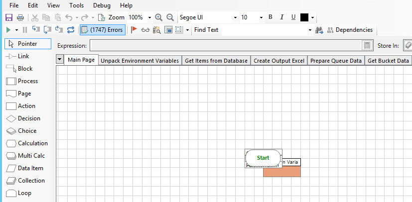

Code Migration Issue from BP 7.1.1 to BP 6.4.1

Yes, this is a known issue. It's due to a change that was made in the XML representation of processes/objects in Blue Prism with v6.6. There's a utility on the DX that can be downloaded to address this. You can find it at the following link:
https://digitalexchange.blueprism.com/dx/entry/3439/solution/compatibility-tools

We are in similar situation, our Dev environment is on higher version 7.1.1 and STG & Prod are on lower version (6.10.1) yet to be upgraded. We have one urgent process which needs to be migrated from Dev to STG and Prod. Question is are release file backward compatible? are there any risk which we should be aware or be cautious.

A bprelease from v7.1.1 should work fine in v6.10.1.

It worked for me as expected. I just noticed the targeted versions are from BP 6.5 to BP 7.1. My requirement was in BP6.4.2. Anyway I converted to BP6.5 and imported to BP6.4.2 and it worked well.
May I know is there a chance to include previous versions below BP 6.5 in this tool in coming days.

We have no plans for going back beyond v6.5 at this time. However, I believe that in most cases a .bprelease converted to v6.5 will likely work with v6 to v6.4. The only items that will cause problems, to my knowledge, will be Web APIs and Skills. This will no work with any BP release before v6.4 as that's the version they were introduced in.
