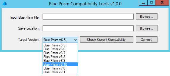

It worked for me as expected.​ I just noticed the targeted versions are from BP 6.5 to BP 7.1. My requirement was in BP6.4.2. Anyway I converted to BP6.5 and imported to BP6.4.2 and it worked well.
May I know is there a chance to include previous versions below BP 6.5 in this tool in coming days.

We have no plans for going back beyond v6.5 at this time. However, I believe that in most cases a .bprelease converted to v6.5 will likely work with v6 to v6.4. The only items that will cause problems, to my knowledge, will be Web APIs and Skills. This will no work with any BP release before v6.4 as that's the version they were introduced in.
