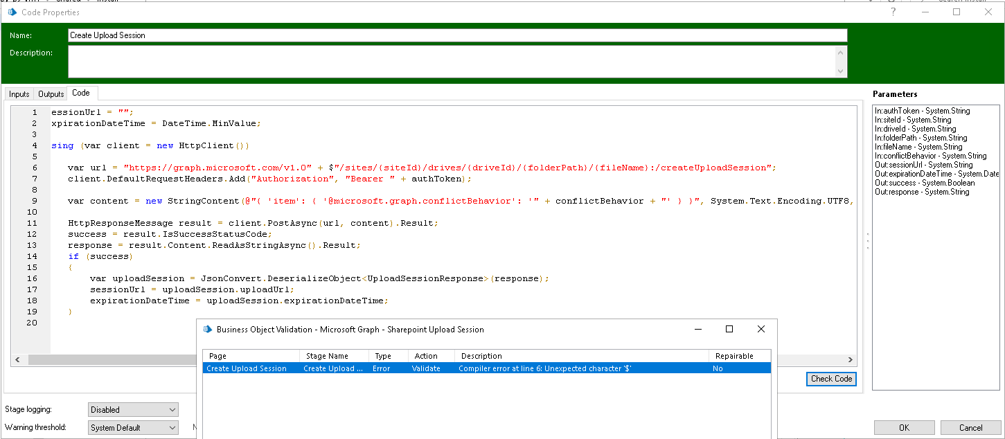

After running the Authentication I am calling the action "Create Upload Session" from the VBO "Microsoft Graph - Sharepoint Upload Session".  However, I received a compile error, it does not recognise the $ on line 6.
Any idea why this might be or how I can resolve it?

Hello @Willem Borgesius,
Couple questions for you:
  1. What version of the Blue Prism are you running?
  2. What locale (ex. en-UK)?
  3. What version(s) of the .NET Framework are installed on your machine?
The $, in this context, is a C# operator for string interpolation. In other words, it's converting everything that shows up between curly braces (i.e. { }) as variables and replacing them with their actual values. The feature was introduced in C# v6 back in 2015, so I imagine it shouldn't be an issue of older .NET version. ​
You can change the line to the more traditional string concatenation format. Following is an example. Just replace the line in your VBO with this one:
string url = "https://graph.microsoft.com/v1.0/sites/" + siteId + "/drives/" + driveId + "/" + folderPath + "/" + fileName + ":/createUploadSession";
That should take care of you.
Thanks Eric, that replacement code works fine.

@Willem Borgesius,
Glad to hear the revised line works for you. BP v6.6 requires .NET v4.7 or later which would be at least C# 7, so that doesn't seem to be the issue here. We'll try to fine some time to recreate your environment and see if we can get the same exception because we're not seeing it in our environments. 🤔
