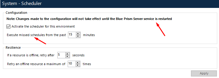

Hola Pedro - I'm afraid I don't speak Spanish and Google has translated for me.
If you have 1 license then it means you can only run 1 process. You can create many processes but you cannot run more than 1 at the same time. If there is already a process running when the scheduler wants to start another process, then the license limitation will prevent it. The scheduler does not really queue executions but it does have the ability to recover schedules that were recently missed.

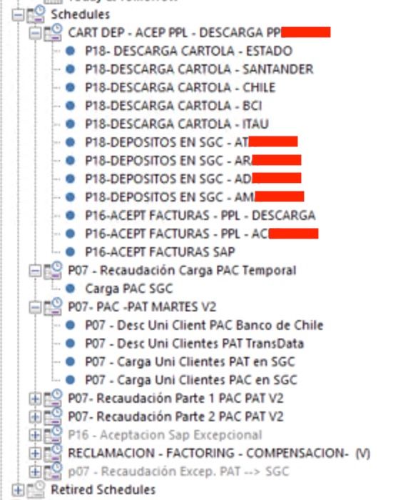

31-03-21 01:57 PM
Nosotros para subsanar ese problema dejamos el schedules en cascada y así cada bot comienza después de que termina el anterior, independientemente del tiempo que se demore
