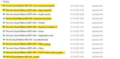

Thanks @ewilson .  Can you check the possibility of housing similar type of endpoint under one asset like end point on issue can be put together.

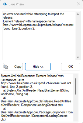

also, i am not able to import below highlighted yellow color asset, all failing with error snip which i also attached. can you fix those.
