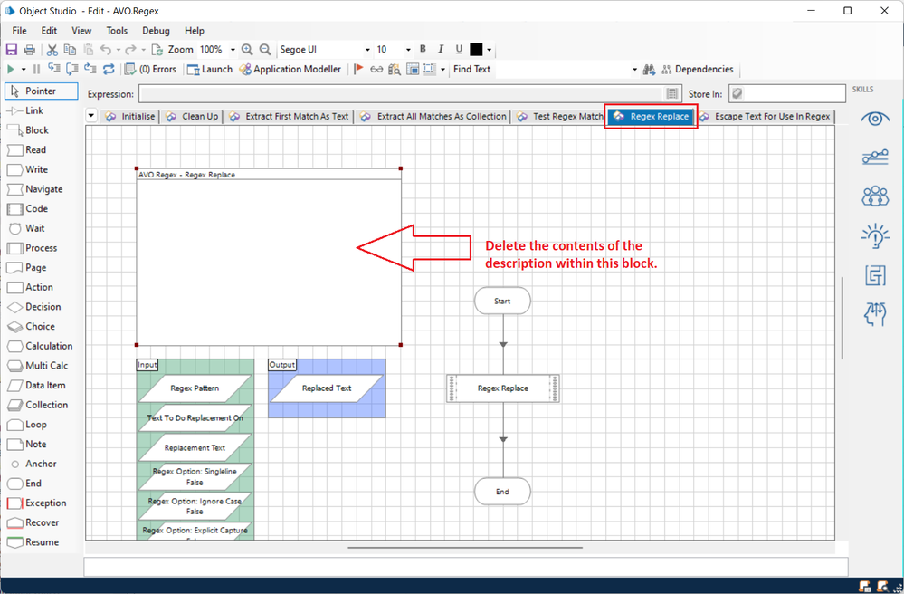

@emmett.r.blake,
I figured out the issue. Open the VBO and go to the ​Regex Replace action. Double-click on the Page Information block, highlight the contents of the Description and delete it all. Yes, weird I know, but it works for me. I can't explain what it is that BP doesn't like about the contents of that description, but removing it will allow you to move forward with the VBO.

@emmett.r.blake,
@ewilson,
Weird! Thank you, that seems to have fixed things.
I think that shows BP must have some sort of memory management problem with description text for that to interfere with loading an object.​
Thanks again,
Emmett
