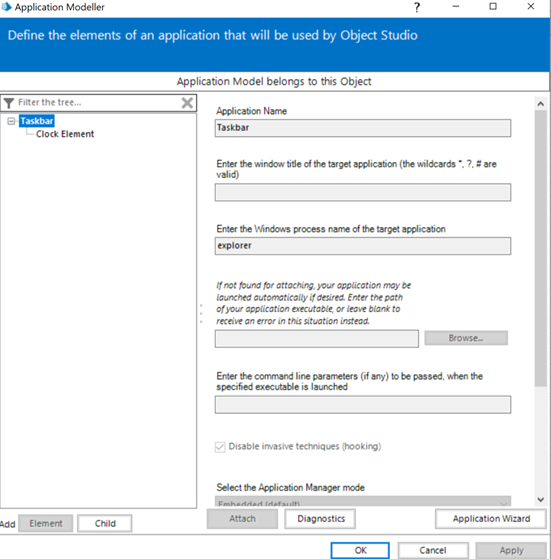

Hi @Antonio Perez ,
For your use case, I want to check if hover is the only option, or would it be fine if you can click as well on the System Clock tray button. As achieving the later can be comparatively easier.
You can create a new business object for the same with process name as 'explorer' and make it an attachable object rather than a launchable one as shown below:
Post this, you can spy an element with the following attributes in AA (Active Accessibility) mode:
TIP: If you are not able to spy element use 'Application Navigator' functionality to get the corresponding element.

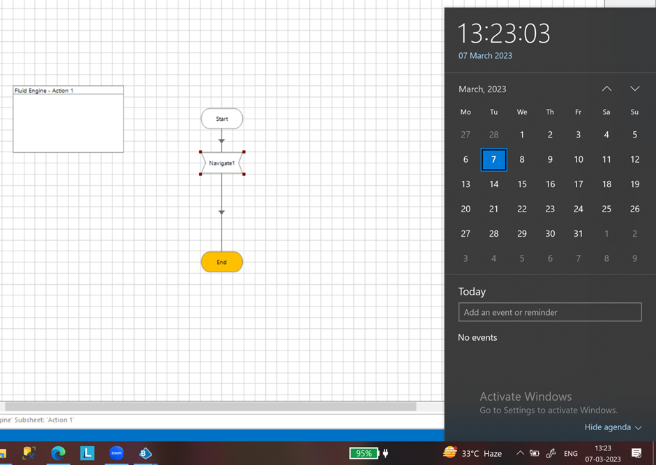

You can then use a Navigate stage and simply use Global Click Center action in it to display the same on the screen:
Another approach can also be to use a Navigate stage on the taskbar window altogether and then use the Global Send Key Events function to execute the following shortcut: Win+ALT+D
The Blue Prism equivalent send key notation for this would be: <{LWin}<{ALT}d>{ALT}>{LWin}>
