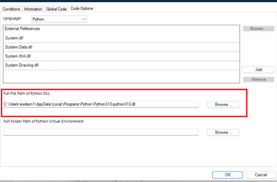

@matiasskwarko84 well, this is embarrassing. 😞 I forgot to mention in the user guide that you need to open the VBO and set the path to the Python DLL on your system. I'll update the user guide today or tomorrow.
Eric
ewilson
Actually, I did add that step in the Configuration section of the User Guide. 🙂 It's on page 5.
