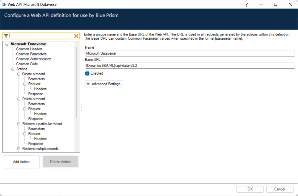

15-12-22 03:28 PM
Based on what I see in the Web API definition you should try your URL without the trailing "/". Pass it in as https://testrpadev.crm11.dynamics.com. Following is a screenshot of the Base URL setting in the Web API. You can see that it takes what you pass in as the Dynamics365URL value and appends /api/data/v9.2 to it. So, if you include a trailing "/" you'll end up with an invalid URL.

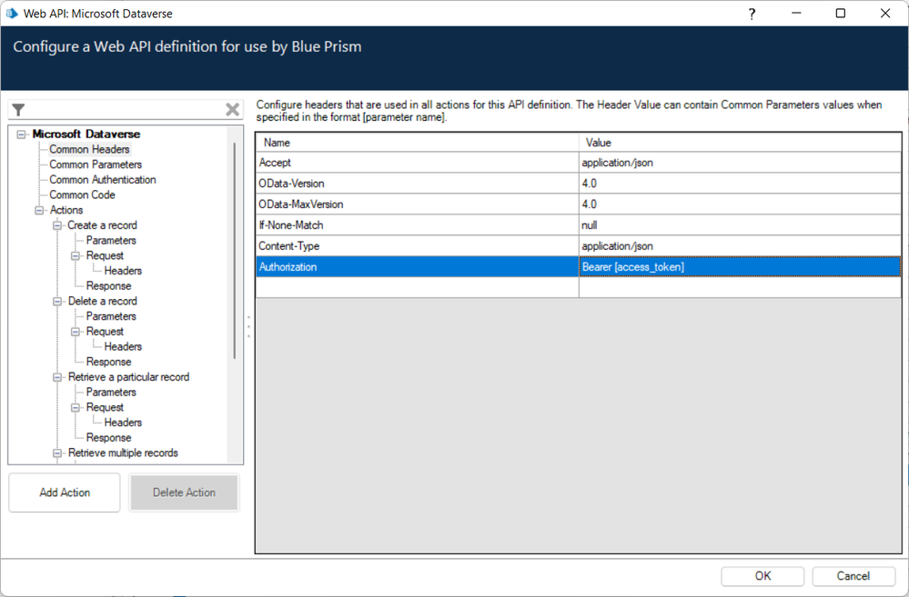

15-12-22 05:42 PM
Going back over the Web API definition and I think I know what might be the issue. Even though you're getting a token back from the authentication VBO and passing that in to the Web API it seems the Web API isn't actually doing anything with it. 🤦♂️
Here's a test you can run.
- Open the Web API definition in Blue Prism (System -> Objects -> Web API Services -> Microsoft Dataverse)
- Verify there's a data item defined in Common Parameters titled access_token.
- Go to Common Headers and create a new header as depicted below:
Click OK to save the change and run your test again.

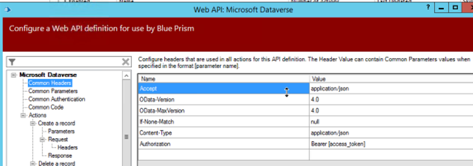

15-12-22 06:31 PM
As suggested by you, I ensured there's a data item defined in Common Parameters titled access_token. Please refer the screenshot below
Also, I have created a new header under common header's
Not sure if I am missing something, basic ?
