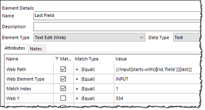

If the fields are numbered consecutively and they appear in the page's HTML one after another, there is a couple of quick ways determine what is the current last field.
The way I would not recommend is create an element with the attributes of Match Reverse, with a Match Index of 1 and put a wildcard on the Web Id attribute (Field*).
The way I would recommend is create an element that uses an XPath expression the would give you the last element that matches those IDs:
(//input[starts-with(@id,'Field')])[last()]With either method above, you can then use the Get ID action in a read stage to retrieve the ID of the that last element to parse out the number of fields.
31-05-24 08:24 PM
