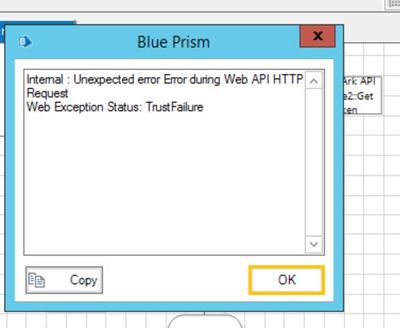

After configuring the web URL in blueprism and calling the same, getting the below error

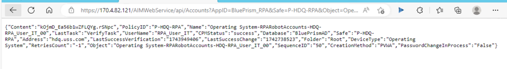

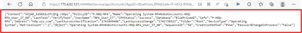

When i tested the same URL in browser i am getting success code.

This error is caused by a trust relationship to the web address of the API. It occurs when you are using HTTPS:// to address the URL instead of HTTP, and there is an issue establishing a secure connection to that web address. Normally this can be verified by opening a browser and browsing to the base url of your API, where you can observe a message stating the site is not secure, or there is an error with the certificate.
We'd recommend working with your IT team to detrermine why the certificate is not trusted. Some common issues include the certificate being expired, the cert being issued to a different domain (i.e. to the FQDN instead of a short name), or if the cert is self-signed/issued by an untrusted authority.

The above-mentioned Api URL is working when we hit directly in browser but getting error via Rest api call

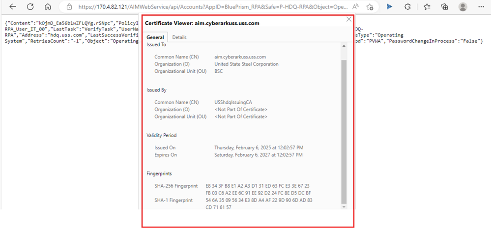

The certificate is trusted and not expired. We could see that certificate is under Trusted Root Certificate Folder also.

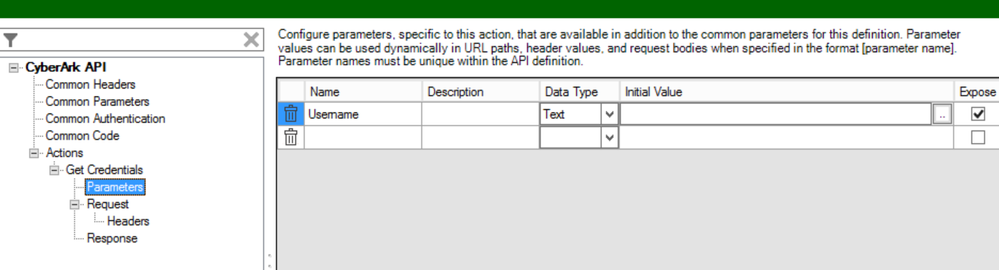

I have read the document attached in CyberArk Integration from Digital exchange, regarding rest api configuration i was confused about what values we need to initialize in both Parameters collection input data item and Client Certificates collection input data item.
we don't have access to download the VBO in Client Machines directly.
Please find the attached screenshots for you reference

The only thing that stands out in your example is if the user account with permissions to access the site via a browser is the same user account attempting to access it via the API call. I'd suggest verifying the user/machine are either the same, or have the same permissions/access to the cert.
