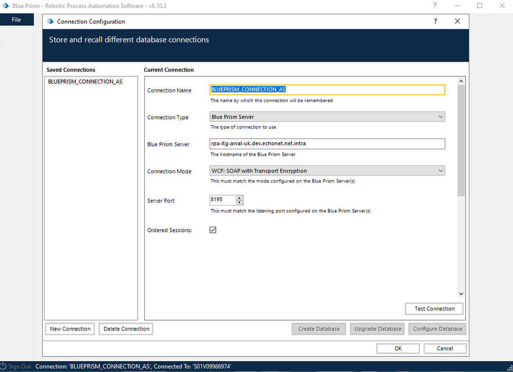

The connection set up is as per below:
Please could someone let me know where i can find the:
DB Name
DB Credential
& Also if the server name needed is as per the above screenshot.

The screenshot you showed is the connection to the Blue Prism Server.

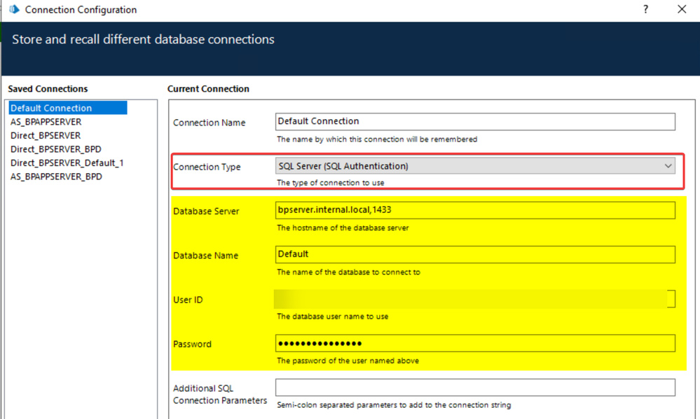

You need to find a VM that has Direct Database connection to the Blue Prism Database - normally you can find that on the Blue Prism Application Server VM. For instance, if you login to the VM rpa-itg-arval-uk.dev.echonet.intra, and open Connection Configuration, you should find a connection that looks like this one (note the Connection Type below should be SQL Server (SQL Authentication) or SQL Server (Windows Authentication)😞
- If you use SQL Server (SQL Authentication), you will need to obtain an account with read-only access to the BPAResource, BPASession, BPAGroupResource, BPAGroup tables from your DBA, then update the bpdbreader credential with the account username and password.
- If you use SQL Server (Windows Authentication) then the VM running the DRM Controller process will need to have a service account that can access the SQL Server and Blue Prism database - normally the Application Server VM should already have access if it's using the SQL Server (Windows Authentication) connection type. In that case you can test the process on the Application Server.
