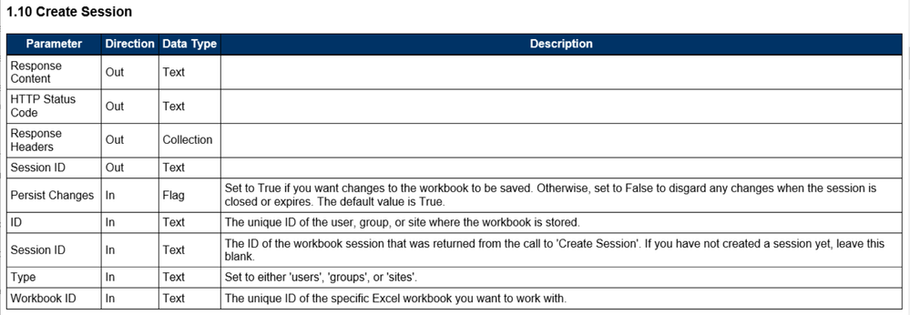

 - With Excel, a bit of a more fundamental issue this one - how do you open a file?! I'm able to download a file, which I could then feasibly use the Excel VBO to do any manipulation that I require before uploading it again and deleting the old version, but this seems like a very haphazard way of going about things. I assume that I need to rub the object 'Create Session'? If so, could I have a bit more of a clearer explanation as to the Input Parameters needed to identify the relevant file? I assume that 'ID' is the Site ID with Workbook ID the ID of the Excel file itself (found via Get Drive Items in SharePoint)?

With Excel, yes you'll use Create Session to get your work started with a specific workbook. Check the embedded user guide on the connector for descriptions of the input fields.

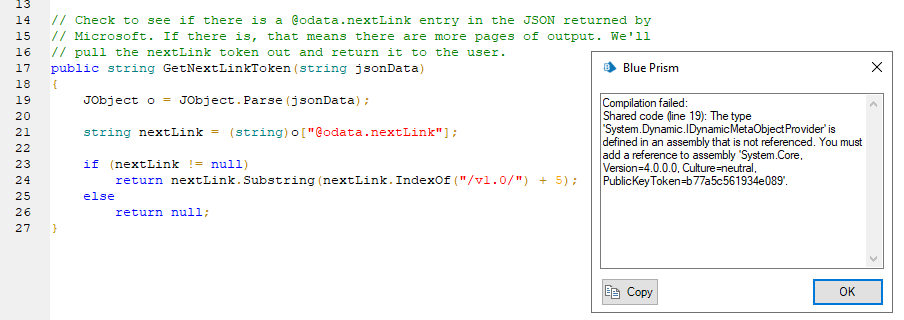

As for the Excel documentation, I had looked at that, but I think it's just the last couple of parameters there that have confused me - For Workbook ID, I've navigated to the relevant folder using the SharePoint connector and have grabbed the 'id' value from that - so essentially, I'm treating 'Workbook ID' as 'File ID' - is that correct? Also, for the 'Type' parameter, I'm unsure what those values pertain to - whenever I try any of those suggested values (and assuming Workbook ID = File ID), stepping over the action returns this error message:
Internal : Unexpected error Cannot execute action "Create Session" because an error occurred while compiling custom code. Errors were found in the following locations:
Shared code

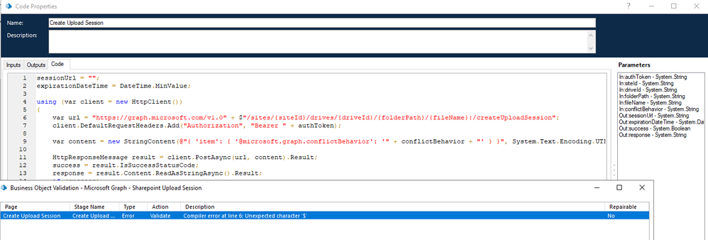

EDIT: Sorry to 'cross the streams', as it were, but I'm currently trying to configure 'Microsoft Graph - Sharepoint Upload Session' from the DX, but am getting a Compiler error (screenshot below). I've had a similar issue before, potentially down to the version of .NET framework we're running on. Am I OK to strip the dollar sign from this code? Only that when I do remove the character, I'm consistently presented with the following error message in the Response Body of the action 'Create Upload Session':
{"error":{"code":"BadRequest","message":"Resource not found for the segment '{folderPath}'.","innerError":{"date":"2022-08-23T14:19:44","request-id":"2e52c20c-e415-4092-a4fb-c0e7b769057d","client-request-id":"2e52c20c-e415-4092-a4fb-c0e7b769057d"}}}

Hi @john.hammond,
That's an interesting error. The $ is a feature that was introduced in C# v6 back in 2015, I think, for string interpolation. I assume you're on .NET Framework 4.7 or later, correct? C# v6 was introduced as part of .NET Framework 4.6.​
You can remove it, but you'll have to change the whole string such that you'll be concatenating the parameters together with the string. Either that, or you can replace the $ with String.Format(). Here are some examples:
// Example 1: Concatenating parameters.
var url = "https://graph.microsoft.com/v1.0/sites/" + siteId + "/drives/" + driveId + "/" + folderPath + "/" + fileName + ":/createUploadSession";
// Example 2: String.Format()
var url = "https://graph.microsoft.com/v1.0" + String.Format("/sites/{0}/drives/{1}/{2}/{3}:/createUploadSession", siteId, driveId, folderPath, fileName);
Regarding the Type parameter in the Excel connector, this refers to whether you're trying to work with a spreadsheet that stored in a user drive, group drive, or SharePoint drive. If you take a look at the Microsoft Graph API you'll see they expose multiple endpoints for just about every action depending on the data you're trying to work with. So, as an example, if you wanted to worked with an Excel spreadsheet that was stored on a SharePoint site you would set Type to site. What this ends up dong behind the scenes is changing the underlying URL path that's used in the REST request.

EDIT: Sorry @Eric Wilson, sent another reply to you regarding a potential missing dll which I now cannot find (in relation to the Excel connector). Found the dll and put it in the BP folder, but was still getting the issue. Investigated the Common Code for the Excel Graph API call and was presented with this message, if you have any ideas?!
Also, just spoken to someone more in the know than myself, and apparently we might be using .NET framework 3.5 (!!!), which might be limiting my functionality somewhat.

That issue I was having RE: Shared Code when opening a file using the Excel API appears to be linked to a missing dll from the object on the DX - should Newtonsoft.Json.dll be mentioned as a prerequisite/download?​​
John Hammond
