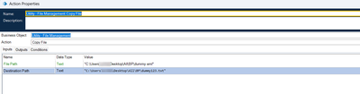

Hi @stepher
I copied the .eml file from the following GitHub repository and converted it into a text file manually and also tried using utility file management copy action
GitHub - Dummy EML File
So i think you can try Depending on the format of the email, you can convert the file to either a text or HTML file and then read the data from there.
