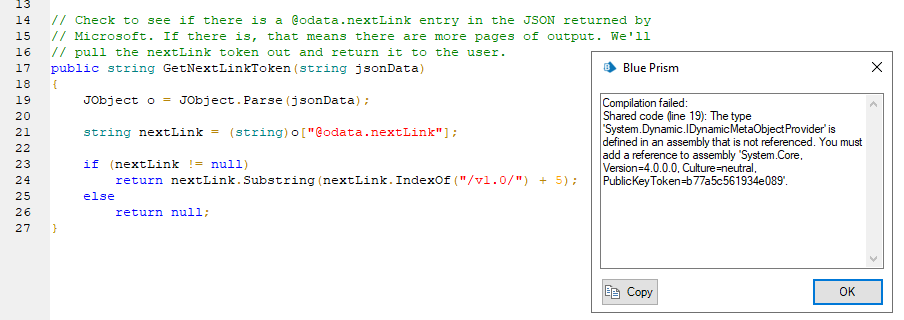

Sorry @Eric Wilson, I'm not being particularly clear with my plethora of multiple questions. This issue relates to the Excel Connector for Graph. As of right now, I've not been able to get any functions working from this - whilst stepping through/over any stage within the Studio, I get the error message 'Internal : Unexpected error Cannot execute action "Create Session" because an error occurred while compiling custom code. Errors were found in the following locations: Shared code'​​. When looking at the Common Code on the API definition section in System, and checking this code, I get the following error message:

That's interesting. I don't receive that error when I use the Graph connector for Excel. What version of Blue Prism are you on? It must be at least v6.4 otherwise you wouldn't be able to use WebAPIs. Regarding the .NET Framework version, you should be on at least some variant of v4 (ex v4.7) as that has been the base requirement of the BP platform for a while now. I don't think the software will even function if you only have .NET 3.5 installed.
Have you tried adding a reference to System.Core.dll to the Global Code options?

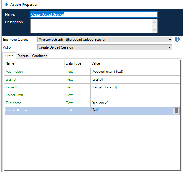

Hi again @Eric Wilson. I'd just like to say thank you for your continued help and patience with trying to help me understand this! Added to my own lack of understanding, our Azure AD person is having some difficulty getting his head around this specific issue as well. When trying to create an Upload Session (or even use a regular upload using the SharePoint connector), I'm getting the following error message:
​{"error":{"code":"accessDenied","message":"Access denied","innerError":{"date":"2022-09-14T07:40:35","request-id":"31699107-cc04-4a22-84d4-c219fd950ec4","client-request-id":"31699107-cc04-4a22-84d4-c219fd950ec4"}}}
'Access Denied' is making me think that this is an AD-side issue, although apparently we have full Write access at the site level. Is there a specific permission that these actions require? The only other potential thing I can think that may be causing this is that the 'Auth Token' parameter requires a text data type, so just before the Create Upload Session action in my workflow I have a calculation that pulls the AccessToken password from the authenticator and writes it to a text data item. This then gets passed in. This is the correct way of doing this, right?
John Hammond

The Password​ data type in Blue Prism is nothing more than a Text item that only displays dots for characters. Under the hood, it's still regular text and that's the way the connector sees it. So there's no need to convert it.
See this page from Microsoft regarding upload sessions and Graph. It lists the required permissions based on the type of token you're using (Application vs Delegated).
https://docs.microsoft.com/en-us/graph/api/driveitem-createuploadsession?view=graph-rest-1.0
