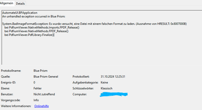

@GeoffHirst Hello, I am getting the following error messages. Unfortunately only in German.
The upper message from the event log comes if you do not put the pdfium.dll into the x64 folder. And the bottom one if it is in the x64 folder. What is strange is that the file is in the correct folder, but the running error is not. What could be the reason?
hi @lorenzwagner ,
I think we need to initially confirm the architecture of the computer you are using here. The first message is architecture related. System.BadImageFormatException has nothing to do with gifs or jpgs, but instead, occurs when a .NET application attempts to load a dynamic link library (.dll) or executable (.exe) that doesn't match the proper format that the current common language runtime (CLR) expects. In other words trying to load a 64Bit library into a 32 bit application.
So, I think we need initially to confirm without doubt what the architecture is of the machine you are working with, whether that be 32-bit or 64-bit and also the architecture of your Blue Prism, as it is possible to run the 32 bit Blue Prism on a 64 Bit version of Windows.
Once you know this, you can confirm that, the files you are using are of the correct architecture and are positioned into the correct folder. Remember that there are 2 files required for this asset, one file is pdfiumviewer.dll and this needs to be placed in the Blue Prism folder. The other file is the architecture dependent one and either needs to be in the x86 folder if you are running 32 Bit or in the x64 folder if you are running 64 bit.

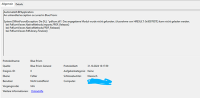

Thank you for your detailed reply. I can safely say that we are running 100% on 64-bit and have the correct DLLs - both PdfiumViewer.dll and PdfiumViewer.Native.x86_64.v8-xfa (64-bit version) - installed in the correct folder. Unfortunately, BluePrism still crashes. I still despair, I don't know what the problem is. The firewalls are switched off and I don't know any other settings. Do you have any other idea what the problem could be? The error from the picture below still exists:
AutomateUI.BPApplication
An unhandled exception occurred in Blue Prism:
System.DllNotFoundException: The DLL ‘pdfium.dll’: The specified module was not found. (Exception from HRESULT: 0x8007007E) cannot be loaded.
for PdfiumViewer.NativeMethods.Imports.FPDF_Release()
for PdfiumViewer.NativeMethods.FPDF_Release()
for PdfiumViewer.PdfLibrary.Finalise()
Maybe using the non-XFA version from here? https://github.com/pvginkel/PdfiumBuild
Hi @lorenzwagner ,
So, from what you seem to be saying, one of the errors has now gone away? The BadImageFormatException? Is that a fair assumption? Now, the above message is saying that it was not possible to find the pdfium.dll. The suggestion here, is that, it isn't where its being looked for. I would expect the 64 Bit version of pdfiumviewer.dll, to look for pdfium.dll in the x64 folder inside the blue prism folder, like this C:\Program Files\Blue Prism Limited\Blue Prism Automate\x64. This is solely for 64 bit Blue Prism.
