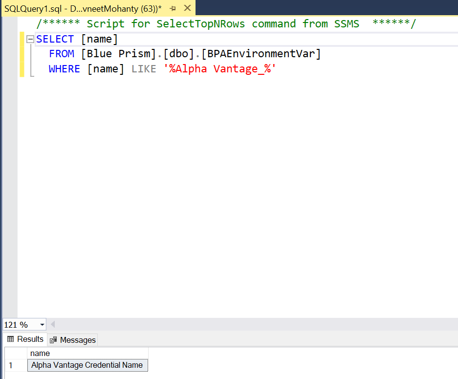

But I can suggest that if you have the access to the back end database SQL Server, then you can create a custom business object or a process which can use the SQL Server VBO and try to use the following query:
SELECT [name]FROM [Blue Prism].[dbo].[BPAEnvironmentVar]WHERE [name] LIKE '%MyProcess_%'This query will fetch the names from the
BPAEnvironmentVar table which can retrieve all the process names for you. Below is a sample query snippet for your reference.
