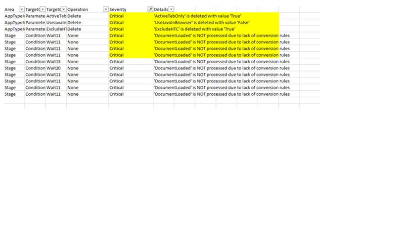

Currently we are in the process of converting IE to Edge compatible objects using Application modular tool (Suggested by DX).
After migration, we observed that some actions are critical/Document loaded are showing in the excel report.
For critical actions we need to re-spy them again and we require manual effort also.
Can you please suggest and provide solution on how to overcome these critical actions/ Document loaded. PFA screenshot .
Uma Manikanta.

From the developer of the App Modeller Migration utility:
"If I understand correctly, the ask is to reduce the number of critical errors or Document Loaded.
Document Loaded is one such action that has yet to receive an equivalent in modern browser mode. The current conversion rule uses the closest action possible, and that action varies between Blue Prism version to version. Details can be found at https://github.com/blue-prism/ApplicationModellerConversion/blob/master/BROWSER.md.
The reason many entries are marked as critical is largely due to the same reason as Documented Loaded, there is no equivalent action/condition exists in modern browser mode. This prompt developers to examine the specific case, to understand if any action needs to be taken.
All in all, the limitation is not with the tool itself, but largely the feature gaps between IE mode and modern browser mode. Hope this helps."
