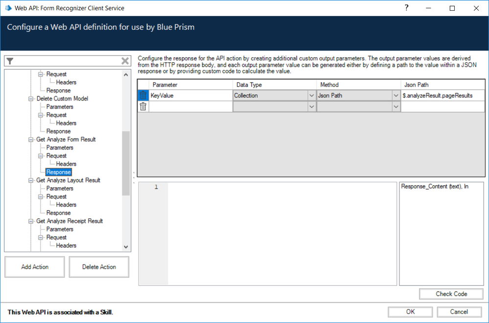

13-10-21 02:25 PM
Hi @Juha Leppänen,
According to the Web API service definition for the skill, there is an output parameter exposed by the Get Analyze Form Result action called KeyValue. It is a Collection that's supposed to be automatically populated using JSON Path and pulling the results from the pageResults portion of the response JSON. See the image below.
If the Collection is empty, that means the pageResults object in the JSON is empty or missing. If there were an error in the code processing the JSON an exception would be raised by the skill.
There should also be a field in the JSON called status. You might take a look at that and see what the value is. Possible values, according to the MS documentation are:

01-11-21 11:17 AM
@ewilson
Thank you for the answer again Eric!
I checked the configuration for the Web API and everything looks the same. I tried installing the skill again as well but that didn't help either. The skill still returns Response Content json, which includes the results but the KeyValue still doesn't return anything, even though the results can be found from the json response.
It seems like the skill was built against Form Recognizer v.2.0-Preview and we're using v.2.1 which is the newest stable version at the moment. Could it be that the json response is different in the newer version and that's why the KeyValue collection is coming empty? Is it maybe possible to handle the response with some augmented code in the Web API configuration?
The skill has been updated in July 2020. Do you know if these skills are being updated or if there is a way to know about the schedule/potential updates?
All ideas or tips will be very much appriciated! 🙂

@Juha Leppänen,
The KeyValue item is configured to capture the pageResults value from the JSON. The response JSON you posted includes a pageResults object in the JSON, but it is empty. It does include a populated readResults object though. What's the difference? According to Microsoft:
and
If you want to populate the KeyValue Collection with the contents of the readResult object you can change the definition of the KeyValue entry on the Response page to $.analyzeResult.readResults.
We should probably look at updating the WebAPI to expose multiple Collections in the response. One for each of the major results objects in the JSON.
and
09-11-21 03:07 PM
Thanks for the help @ewilson!
I tried changing the response and now I get the KeyValue collection populated. It still needs some parsing but at least the Skill populates the collection now.
