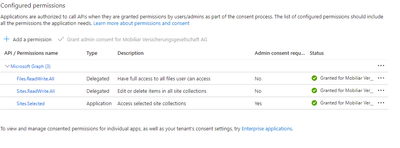

Could it be a permission problem? Attached you can find the BP API permissions.

@EasyBluePrism I believe you mentioned that you're using an Application Access token. If so, that is probably your issue. This is one of the annoying things about Microsoft's Graph API. Different endpoints support different token types. Some support both Application Access and Delegated Access while others support only one or the other. In the case of updating or writing to a worksheet, the Graph API only supports Delegated Access tokens.
The reason you're not seeing an error response is because Microsoft doesn't return an error when using an Application Access token to write data to a worksheet. They simply ignore the request. Blaming Blue Prism, as you have, is entirely misplaced.
As I mentioned before, you need to take some time to get familiar with the Graph API. If you do, you'll be much better prepared to work with it. I'd also recommend checking out Microsoft's Graph Explorer utility which can be used to replicate the exact API calls the Blue Prism connector is making as a way of validation/verification.
How did I know that a Delegated Access token is needed for writing data to a worksheet via Graph? I checked the Update Worksheet page in the Microsoft Graph API reference. If you open that page and scroll to the Permissions section, you'll see that only Delegated Access tokens are supported.

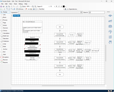

FWIW, here's a shot of my test process which, using a Delegated Access token, runs as expected and updates the desired worksheet.

Thank you Eric. I have now studied the Graph API and am quite sure that the permissions are set correctly:
Now most actions work, except writing an excel. I created the process just like you did:
There is no error message, but the Excel (Sheet2 (Tabelle2)) remains empty.

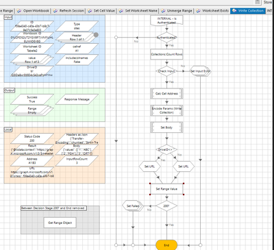

What strikes me is that the range remains empty:
The IDs should be correct, because reading from the same Excel (Tabelle1) works.

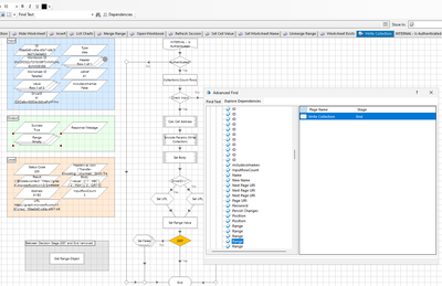

The range always remains empty, since it has no reference at all, as I noticed:
But with the result (Result, ResultHeaderJsonand ResultCode) everything seems fine:

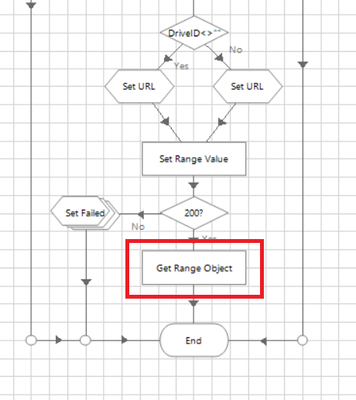

@EasyBluePrism did you download this VBO from the Digital Exchange? If so, do you recall when? You're missing the stage that sets the Range output.
I'd suggest grabbing the current release off the DX.
Eric

You’re right, I had an old version. I have updated all relevant VBOs. Now the range is written, but the Excel remains empty.
