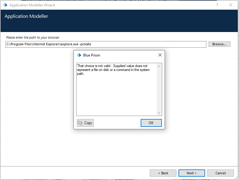

1. Open IE in private Mode - add "-private" in Application Modeller.

Hi Manish, Thanks for your speedy response. I have done this but get an error. I suspect I am putting it in the wrong place or wrong format.
Kind Regards
Gavin

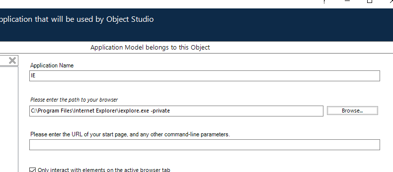

Sorry to confuse Gavin. You can create modeller as usual and modify below
Manish Kumar
Great, thank you Manish, much appreciated. You are all providing a great service to all the users out there.
