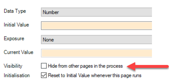

Data can be passed into a page using the input parameters that are accessed by double-clicking the start stage on the page of interest. The values passed in are then stored in data items. Now, it is possible to have what could be called a global data item. This is a data item that sits on a page and has the Hide from other pages in the process checkbox unchecked as shown below.
This data item would effectively be 'global' throughout your process or object. What to watch here is for the value being changed unexpectedly. Ideally, values are passed in as input parameters, held in page local data items and then if needed elsewhere, passed out of the page as output parameters on the End stage.
