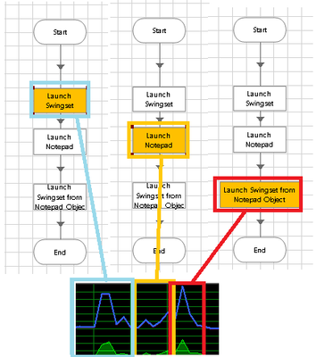

The above example shows a short process containing 3 Objects:
- Notepad Object
- Swingset Object
- Notepad Object with Swingset Launch Action added
As can be observed on the diagram, when launching the third Object, that contains all the contents from the Notepad Object and an Action that calls the Swingset Object, both Objects are loaded into memory resulting in higher memory usage.
Please also note that the larger the objects are, the higher the differences will become potentially even causing “System.OutOfMemoryException” errors.
- Notepad Object
- Swingset Object

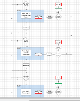

Hi Prachaya,
I recommend segmenting your design into sub-processes.
See example below:
In this case the design has been split into 4 parts:
- The main process that runs the sub-processes sequentially
- The "Initial Checks" sub-process which validates input data, loads the queue if required (if not loaded already), and prepares the environment for work (i.e. mapped drives, temp files, etc.)
- The "Execute Transactions" process, which gets the work items from the queue and works them to completion
- The "Create Reports" process, which creates and sends out MI reports for the work carried out during this run.
This example assumes that all of this should be done sequentially.
If your scenario would require running multiple concurrent sessions and split the workloads between them, then the work loading part would need to be done outside of the main process, via a separate "work loader" process, scheduled to run at required intervals.
Using sub-processes not only reduces the amount of pages per process, but also reduces the memory usage at any given time.
This is because when a Process starts, it loads all of the contents, as well as Objects marked as its dependencies into memory for execution, which is released only once the process ends (e.g. steps through the end stage on the main page)
So the more stages and more objects used, the higher the memory usage will be.
Dividing this into sub-processes reduces this, as when a sub-process is finished it releases the memory it was using.
