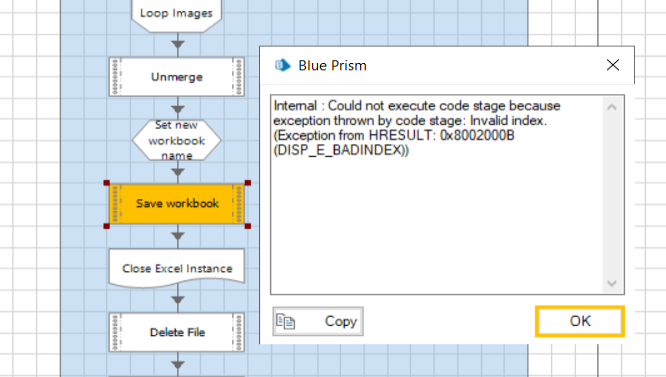

Has anyone use this shared asset in DX? I tried it but got an error below when executing the code stage for Save As.
Could not execute code stage because exception is thrown by code stage: Invalid index. (Exception from HRESULT: 0x8002000B (DISP_E_BADINDEX))

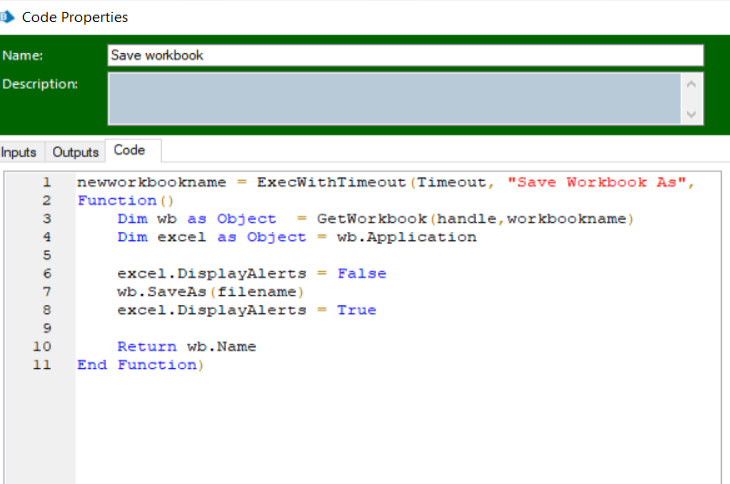

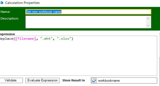

I tried changing the stages you mentioned:
Code Stage:
And still not working.

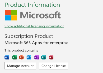

I'm using this version of Excel:

I've been retesting the object and i can only recreate the error when i provide incorrect parameters but there are a couple of things you can try. Change the calculation back to Replace([filename], ".mht", "") and the code stage back to wb.SaveAs(filename,51). Once done double check the inputs for the SaveAs code stage match my screenshot below. Save your changes and re-run your process, if you get the same error the next thing to try would be to move the pdf to another folder location for example on your desktop and then run the process again with the new location for the pdf as the input. Should you still have the same issue then try recreating the error directly through excel. You mentioned before that you get the mht output file so with this file open it with excel and then try to save it as an xlsx file to the original folder and see if you get any errors or warnings.
Beyond this I think the only other thing you could do is, since it fails but still produces the mht file, you can then use the standard excel object actions to open this mht file and resave as an xlsx. This will give you what you need it to be, the convert object only seems to fail on the final step of saving the file as an xlsx so as long as you can get the mht file then you only need to add a few steps to your process to get the final output file. See my other screenshot for an example.

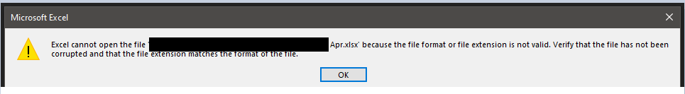

Hi Michael,
I followed the same route of saving the mht file as xlsx using regular MS Excel VBO.
It created the XLSX file but when I open it throws this error and does not proceed further.
Are you guys able to open and consume the resaved mht file as xlsx properly?

Hi @Tejaskumar_Darji
Are you using Save As from the excel vbo or Save? ​have you tried saving it as a .xls instead?

Hi Michael,
We tried the workaround by saving the file as an .xls instead of .xlsx in the regular MS Excel VBO (as mentioned above in this thread), and from there it worked perfectly again!
The display alerts settings were already turned off in the object we used (excel.DisplayAlerts = False), so that we did not need to change.
Thanks a lot!
