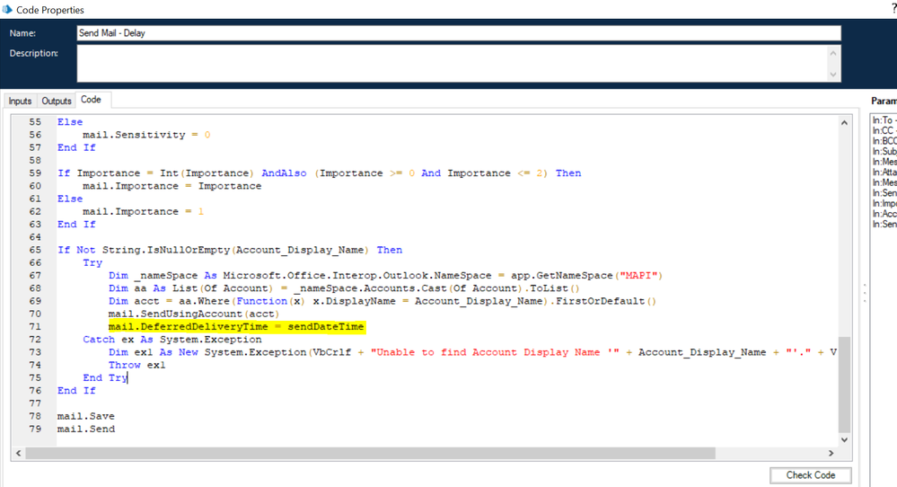

Currently Outlook VBO doesn't have an action to schedule or delay an email. You can create a custom action by following the below.
  1. Take a copy of existing Send Email Action and Rename it.
  2. Add this line in the code stage under Try block. mail.DeferredDeliveryTime = sendDateTime

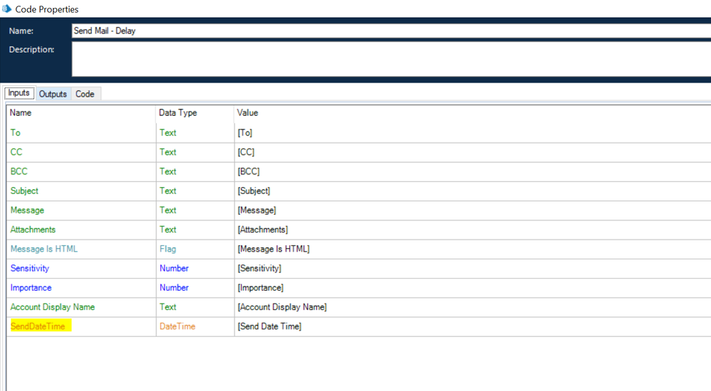

Post creating the custom action in the object, you can follow the below flow.
  • Configure From & To Business Hours under Environmental variables.
  • In your process, you can add a decision stage to validate the business hour. if the current time is between the business hours, then send the email.
  • If the current time is not with in the business hours, then you can schedule the email using the above created custom action.
Alternatively, you can also defer the items in the queue and send the emails during the business hours.

Thanks @Athiban Mahamathi Mathialagan and @Tejaskumar_Darji for your advice.  I tried to create a copy of the send email using the deferred date but that doesn't seem to be working for me.  I think I will go with the advice and update the queue item and defer to email during the working day timeframe.
