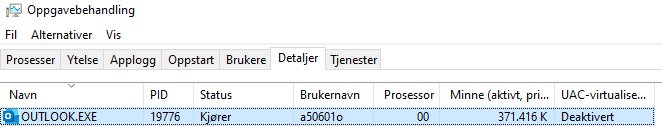

06-10-22 07:32 AM
Hi!
One thought that came to mind.
When it crashes, did you check if the Outlook.exe hangs or uses excessive resources on the RDP User session?
Could it be that the user session runs out of memory after many outlook API tasks? Just a thought.
Another thought, try to kill the Outlook.exe application/Process tree and retry without a reboot. I believe the reboot cleans up hanged tasks/prosesses, so by killing the faulty one, should give the same result without a reboot. Not good on an RDP server, for sure.
Take a look here in Task manager on the RDP session.
Please keep us updated! 🙂
Kind regards RogerThat
14-10-22 09:44 AM
We are a bit closer to the root cause of the issue. We have 5 shared runtime resources and robots run on them randomly. Scheduling is arranged by customer and they cannot pick which resource to use. So there is no dedicated machine for a specific process.
By checking the logs, I found out that the robot only crashes when it runs on 2 out of the 5 VDI's. Although all 5 machines are identical and have the same capacity.
IT informed me that these 2 machines had indeed a different host than the other 3 and moved the 2 VDI's that caused the problem to the other host where the other 3 run.
However, it did not solve the problem yet. The process keeps crashing on the 2 VDI's.
I've checked task manager while it was crashing but nothing special to see. We will continue investigating with IT.
But what I did see is the following: while the robot was generating system exceptions due to "the operation failed", I logged in to the machine through the viewer and unfolded all shared mailboxes so that the subfolders (e.g Inbox, Drafts, Sent Items, Archive,...) were visible and suddenly the robot started treating cases successfully for another 20-30 minutes. Very strange issue to be honest.
