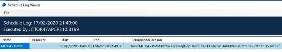

I am having a strange issue with scheduling a process on a newly configured virtual machine (which is setup as a runtime machine). We have already a few virtual machines setup with the scheduler working fine, but our newest virtual machine does not work with the scheduler. It shows 'IDLE' and connected in the control room, but whenever we schedule a process the logs show the same error 'XXX resource is offline. Retried 15 times..'

The Log from recent activity:
