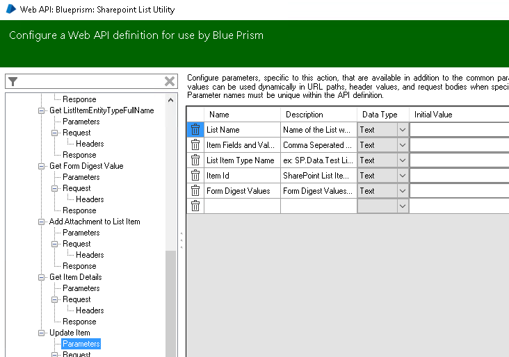

Hi Swathi - Here is my setup.
Hard coded the item/value pair to show the format.

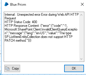

Error Message

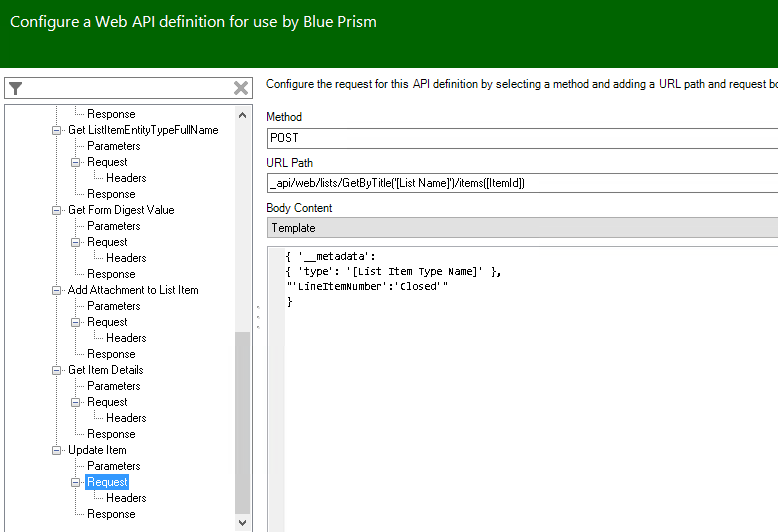

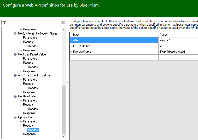

The header looks like the attached file.Share the error message. Ryan has shared all the screenshots and your request should looks like
{ '__metadata':
{ 'type': '[List Item Type Name]' },
[Item Fields and Values]
Swati

This issue is fixed now, problem was unwanted space in the body. also I am passing the item key/value with out double quotes.
