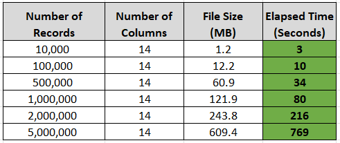

I've conducted some tests using CSV files ranging from 10K to 5M records (14 columns of data per record). Below is a screenshot of the elapsed times to read the various test files.
I tested both options of reading the data (non-chunked and chunked). For the tests up to, and including, 100K records, non-chunked reading worked fine. Beginning with the 500K test, and onward, memory issues arose. From 1M onward, the test failed every time unless the chunking action was used.
Note 1: The times shown are just for reading the data from the CSV file, populating the Collection, and returning the collection to the calling process. Additional time would be required to then loop through the collections to perform whatever business processing is necessary (ex. looking for company XYZ records).
Note 2: These tests were conducted on a 3.5 year old Dell Latitude 7490 with a Core i7-8650U CPU and 16GB of RAM.
Note 3: The memory issues don't magically show up at record 100,001. It varies depending on the system you're running and it's specs. And there's a pretty significant jump between my test at 100K and 500K records.
Not exactly lightning fast, but for a Digital Worker I'd say more than respectable. And best of all, no System.OutOfMemory exceptions. 😉
