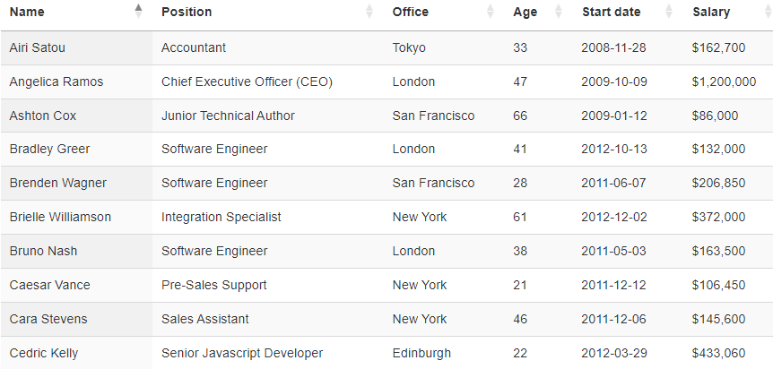

Hi ,
For example Consider the attached as a table present in PDF .I need to extract a pdf data which in table format and write into a collection.Is there any code to read pdf table and write into collection
Sudha Priya
Hi
Not sure why their is difference from initial ask ( was from text file )
coming to the pdf part,
is it native pdf file ? ( mean are you able to copy text to clip board by ctrl+a and ctrl+c)
is the format going to fixed for every file? ( having some constant key words)

@Lakshmi Narayana the flow is like from pdf i have used copy to clipboard and got in text file. so i Initially asked for text to collection.
The main flow is i have to extract data from pdf and put it in collection as mentioned.
Main issue im facing is if I copy to clipboard i can find misalignment of data.
If there any possibility can u suggest any ways

i am not sure if we can retain the exact format by any action.
But what we can do is build regex based on the format what we get
i hope you have gone through the above thread so you will get an idea as the use case is almost same
if you have all possible cases of formats, then it will be easy to build regex
Regards
Lakshmi Narayana
