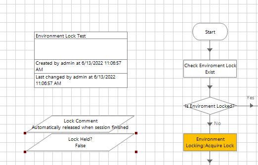

I tried to recreate this scenario but it worked fine for me.
Check below,
After the session ended, the env lock got auto-released, and when I query for lock next time it says Lock Held=False.
Did you try with a new Env lock item and see? Also is there any other process that uses the same environment lock? Because there might be a chance that the different process unlocked it.
Check below,
