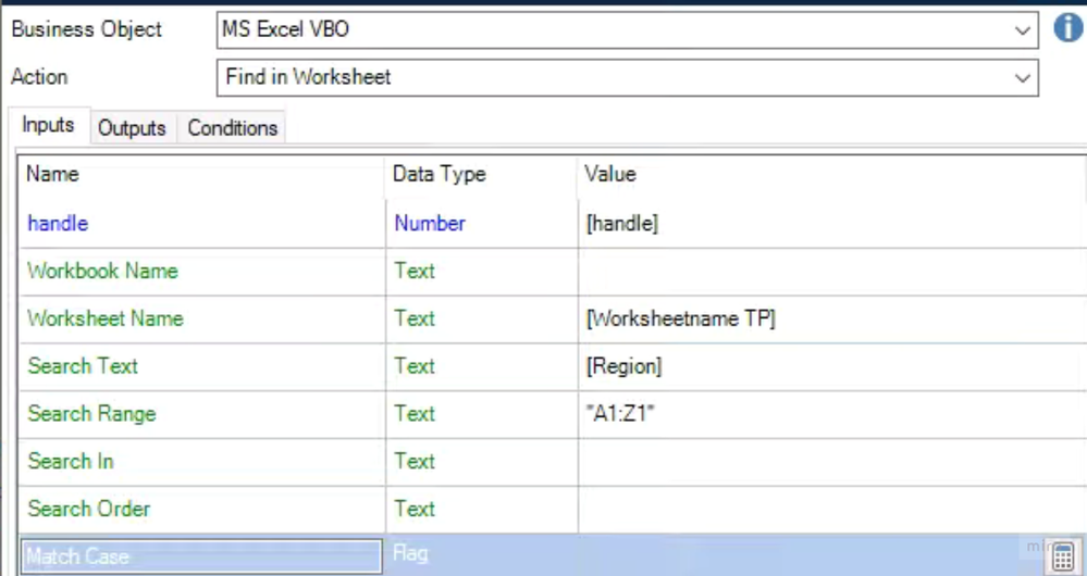

The Excel VBO is way more easy. Just use Find in Worksheet, also you can use a Row to search,
and you have all the needet index to work with and change the Values directly in the worksheet.
