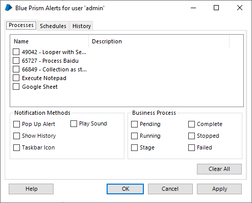

21-09-20 04:30 AM
Hi Team
I have also recently come across this issue, I have disabled (unticked) the "Configured Process Alerts" for all the process, though it is still coming up with the original error?
I have tried to rename one of the process as mentioned above, though this did not seem to fix the issue.
Has anyone else come across a similar issue or further suggestions on what else may resolve this?
