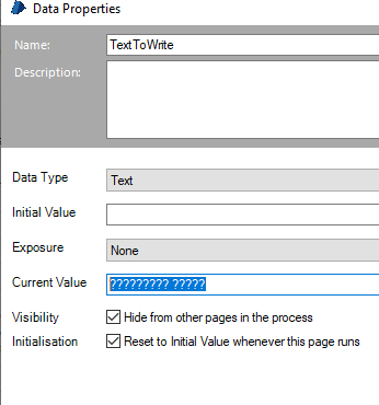

Please, I get data from an Excel worksheet which might contain foreign characters.
However, it is not recognized by BluePrism when I paste that data in SAP.
I checked if BluePrism correctly reads the data from Excel, but I found out that the data collection or data item has "question marks" instead of the cyrillic characters. I have found no similar topic solution in Community Portal. How should I proceed to read foreign (cyrillic) characters?

1) Are they fine in Excel? Yes, they appear fine.
2) How do you get that data from excel? Excel VBO, queries or something else?
I am using "BP MS Excel VBO"'s action "Get Worksheet Range as Collection" to get the data.

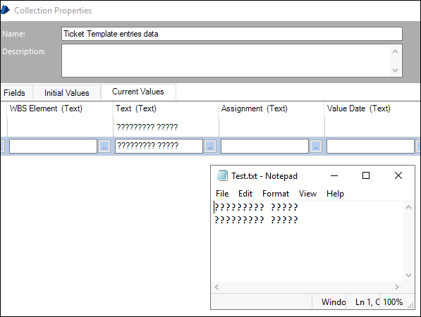

3) Can you write it back to notepad?
No, if write it back, only "???? ????" (question marks) are sent.
So, it is not only a display issue in BluePrism.

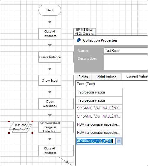

15-09-20 10:02 PM
see the screen shot - I duplicated the action Get Worksheet As Collection and called it Get Worksheet As Collection (Unicode). Then in the code stage I removed "Dim data As String = GetClipboardText()" and put this from the Initialise Action-Global Code. That should fulfill your requirement.
Dim data As String = Nothing
With New Threading.Thread(Sub() data = Clipboard.GetDataObject().GetData(DataFormats.UnicodeText, True))
.SetApartmentState(Threading.ApartmentState.STA)
.Start()
.Join()
End With

18-09-20 08:03 PM
It worked perfectly!
