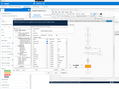

can you please share the application modeler screenshot of that element
Hi Naveed, this is the screenshot when you can see the App modeler, the application on the background and the test result (I see I was wrong: the elements found where 24, the 24th is the first "not found" element)

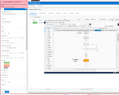

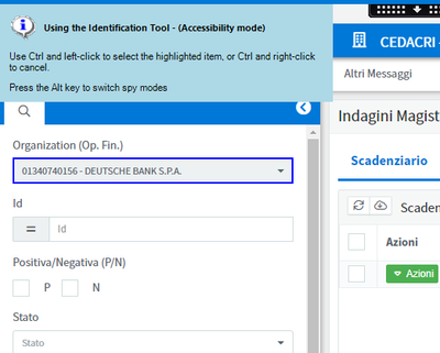

The second part of the story: I just make a generic "Identify" operation, on a generic object, just to do an Identify op:

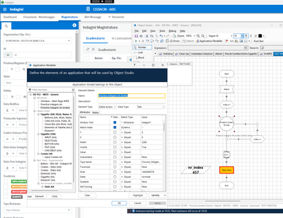

And after this I've relaunched the test, and this is what I obtain:

I've isolated the issue (even if I still don't have a resolution): my issue occurs when an application (in my case (IC.IntegratoreClient, a dot.Net custom application), run an embedded web application using msedgewebview2.exe program.
What happens is that the BPAgent "sees" only the first few items of the embedded app (I still Haven't udersttod which ones, I guess they are the object natively present in the webview window, but not the components of the web application).
The "magic" thing that happes is that if I open an object, even another object, not the one that should interact with the fields of the application, just one that has "IC.IntegratoreClient" as application) and start an identify operation in AA Mode (even if I abort it and don't save anything), then all components of the webview application become visible for my object too and my applicastion can prosecute doing its job.
