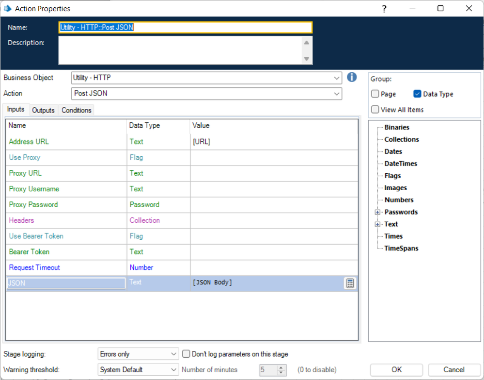

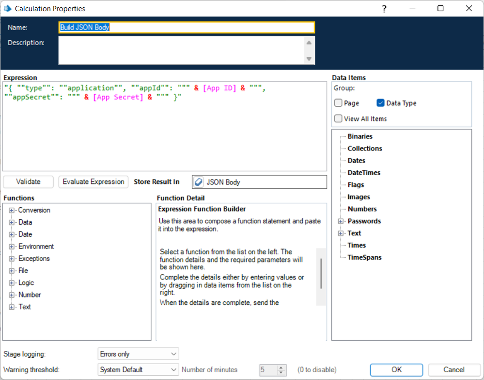

Ok, but the underlying question is still how do you want to call this API? Do you want to use the Utility - HTTP VBO, a Web API Service definition, or a Code stage? Here's an example of using the Post JSON action of the Utility - HTTP VBO:
Utility - HTTP VBO
In a nutshell, you build the content of the request body (shown in the Calculation stage) and then supply it as the input to the JSON parameter on the Post JSON action (along with the URL of the authentication service).
