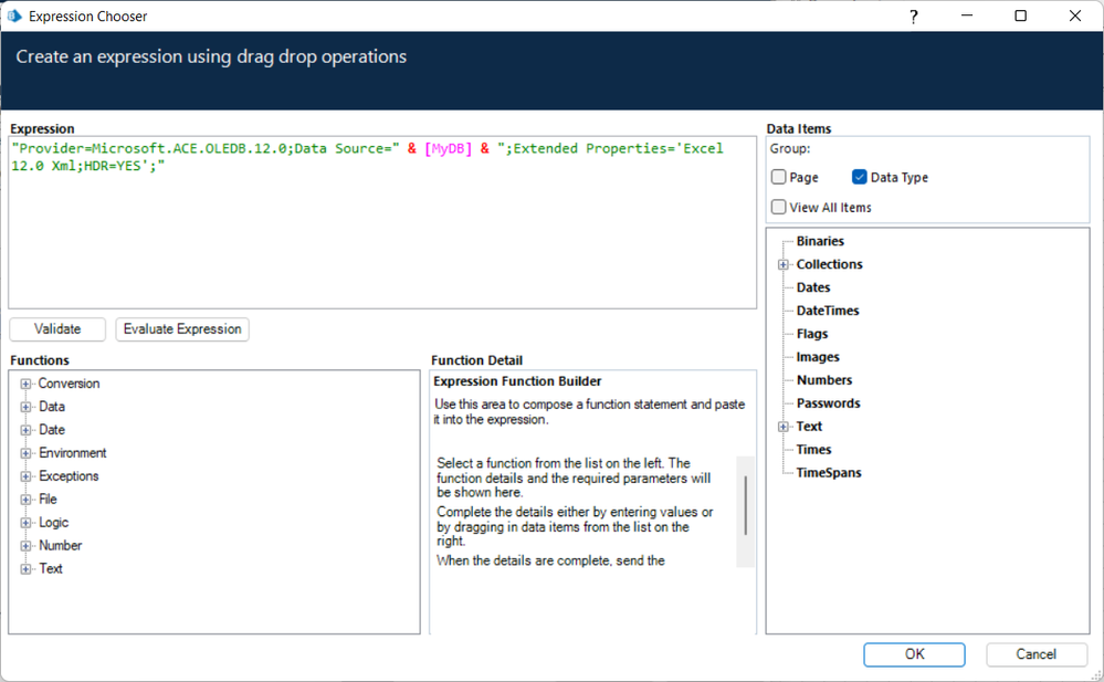

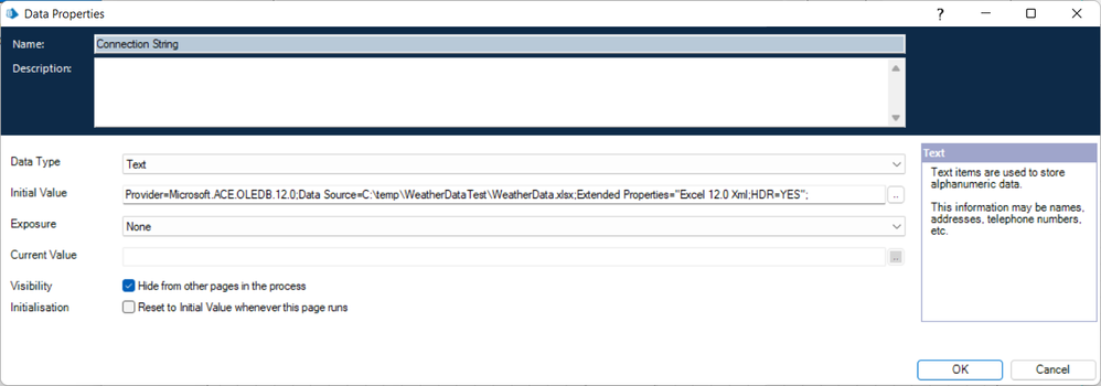

Hello @AbhilashM,
So you're passing in your connection string. Can you show how you're building the connection string? Are you doing something like this:
Or do you build it in the actual Set Connection action like this:
Eric
Eric
